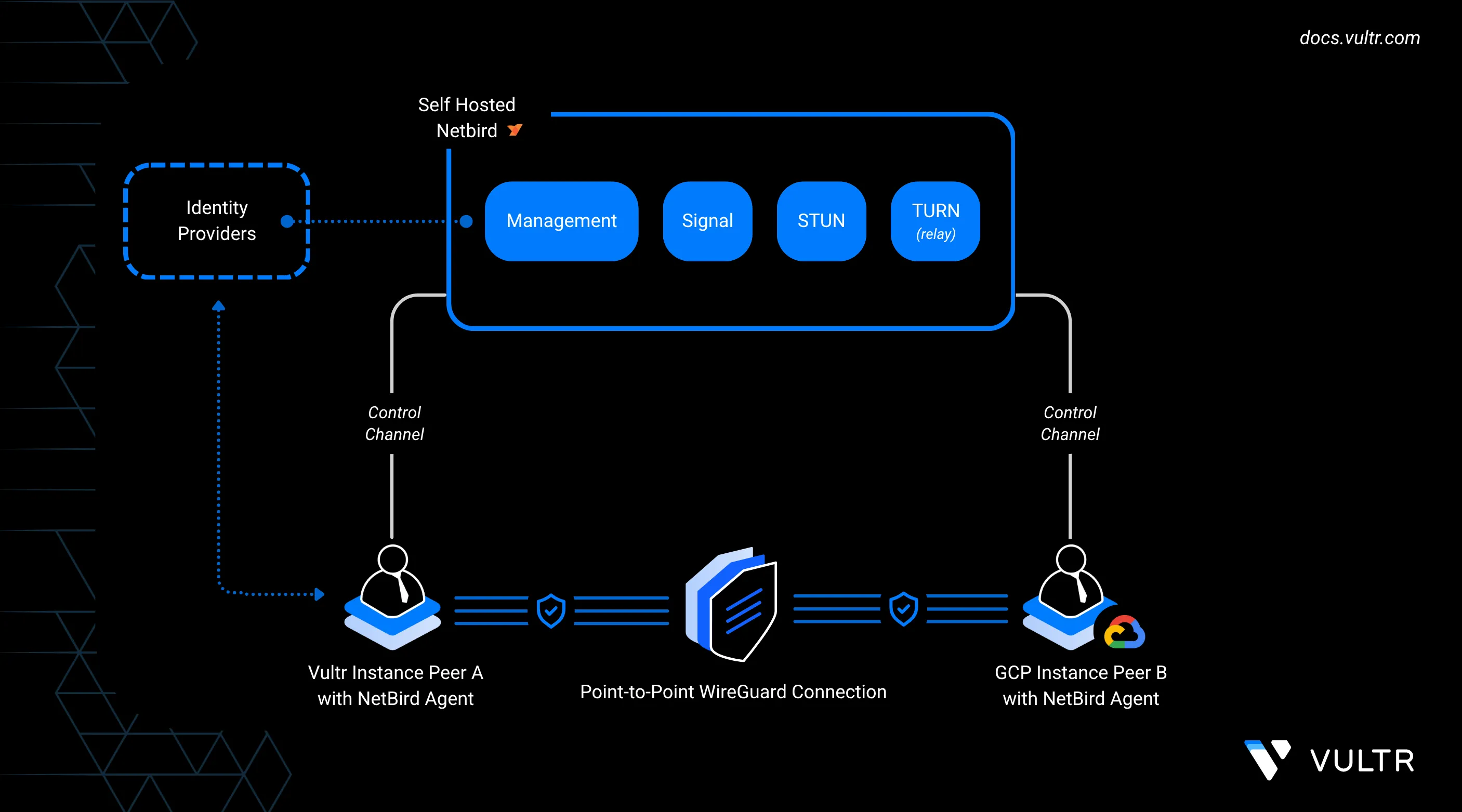

NetBird is an open-source peer-to-peer VPN platform that creates secure, private networks across distributed infrastructure. It uses WireGuard-based tunnels to establish encrypted mesh networks, allowing low-latency connections between nodes without manual firewall or port forwarding.
This guide explains how to self-host the NetBird control plane on a Vultr instance and connect peers across both Vultr and Google Cloud Platform (GCP). By the end, you have a functional multi-cloud mesh network, with peers in Vultr and GCP communicating securely over private addresses. You will also learn how to designate an exit node for centralized egress routing.

netbird.example.com.us-central1).The control plane coordinates all peers in your network and must run on a publicly accessible server. In this setup, you will deploy it on a Vultr instance using Docker. The deployment includes the management service, signaling service, TURN/STUN server, and a default identity provider (Zitadel).

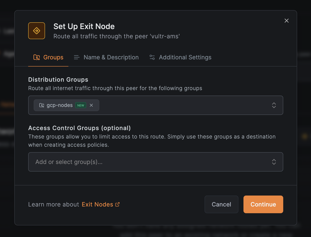

You can configure one peer as an exit node so others route their internet traffic through it. In this example, the Vultr AMS instance will act as the exit node, and the GCP VM will route through it.
In the Peers tab of the Admin Panel, select the peer named vultr-ams.
Scroll down and click Set Up Exit Node.
Assign an identifier, such as ams-exit.
In the Distribution Groups dropdown, select or create a group that will include the GCP peer (for example, gcp-nodes).
Click Save Changes.
The vultr-ams instance is now configured as an exit node.
