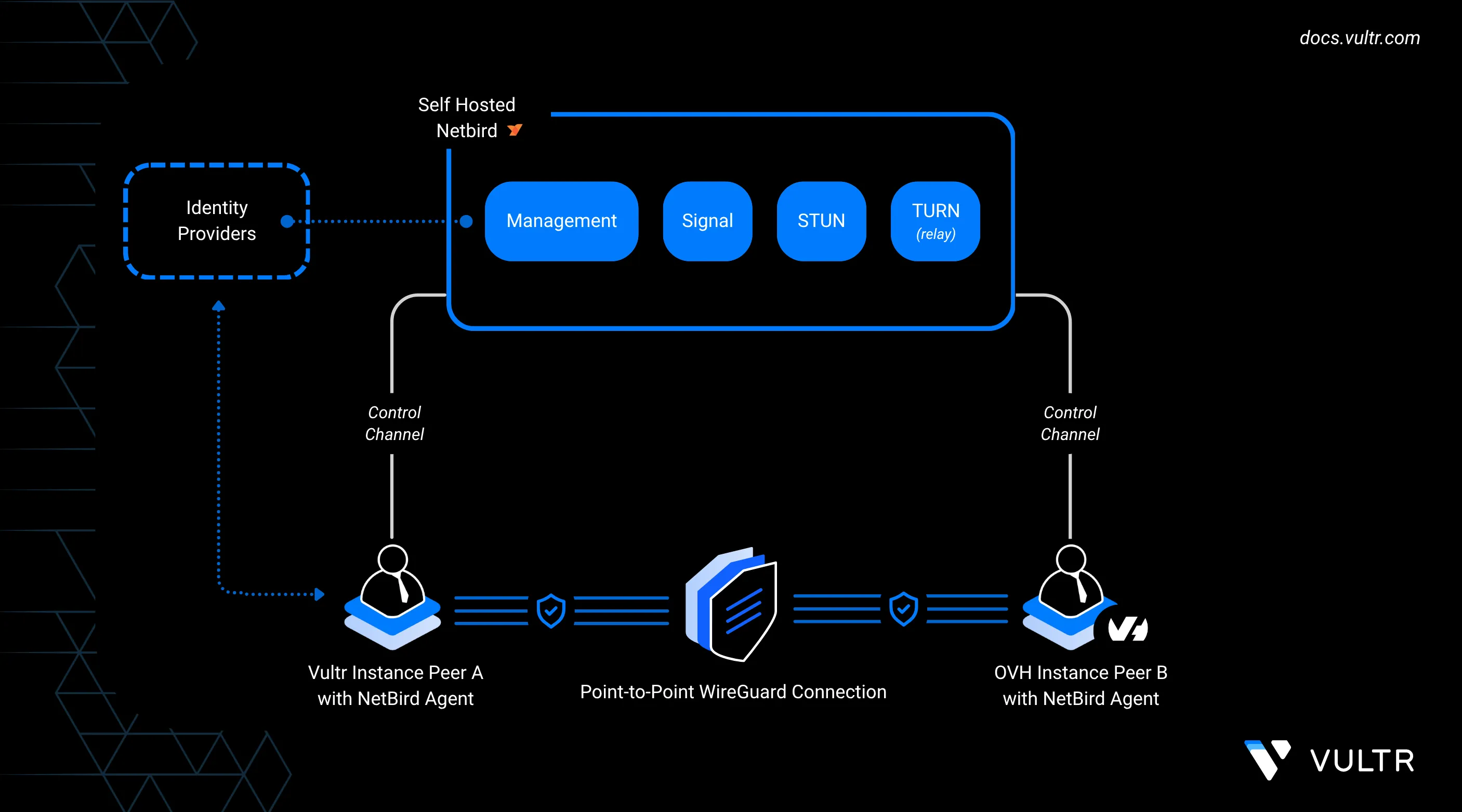

NetBird is an open-source networking platform that uses WireGuard to create encrypted peer-to-peer overlays. Instead of relying on manual VPN tunnels or complex firewall rules, it automatically forms a mesh that lets servers in different locations talk to each other over private, low-latency links.
In this guide, you self-host the NetBird control plane on a Vultr instance and connect it with an OVHcloud server to form a cross-provider network. The steps cover preparing Vultr and OVH environments, adjusting firewall settings, enrolling peers with setup keys, and validating secure connectivity. You also configure a Vultr peer as an exit node so that OVH traffic flows through Vultr for centralized routing and policy control.

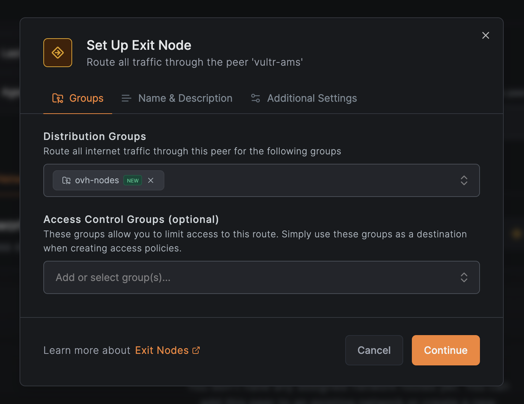

You can configure one peer as an exit node so other peers route their internet traffic through it. In this example, the Vultr AMS instance acts as the exit node, and the OVH peer forwards its traffic through it.
In the Peers tab of the NetBird Admin Panel, select the peer named vultr-ams.
Scroll down and click Set Up Exit Node.
Enter an identifier such as ams-exit.
In the Distribution Groups dropdown, select or create a group that will include the OVH peer (for example, ovh-nodes).
Click Save Changes.
The vultr-ams instance is now configured as an exit node.
