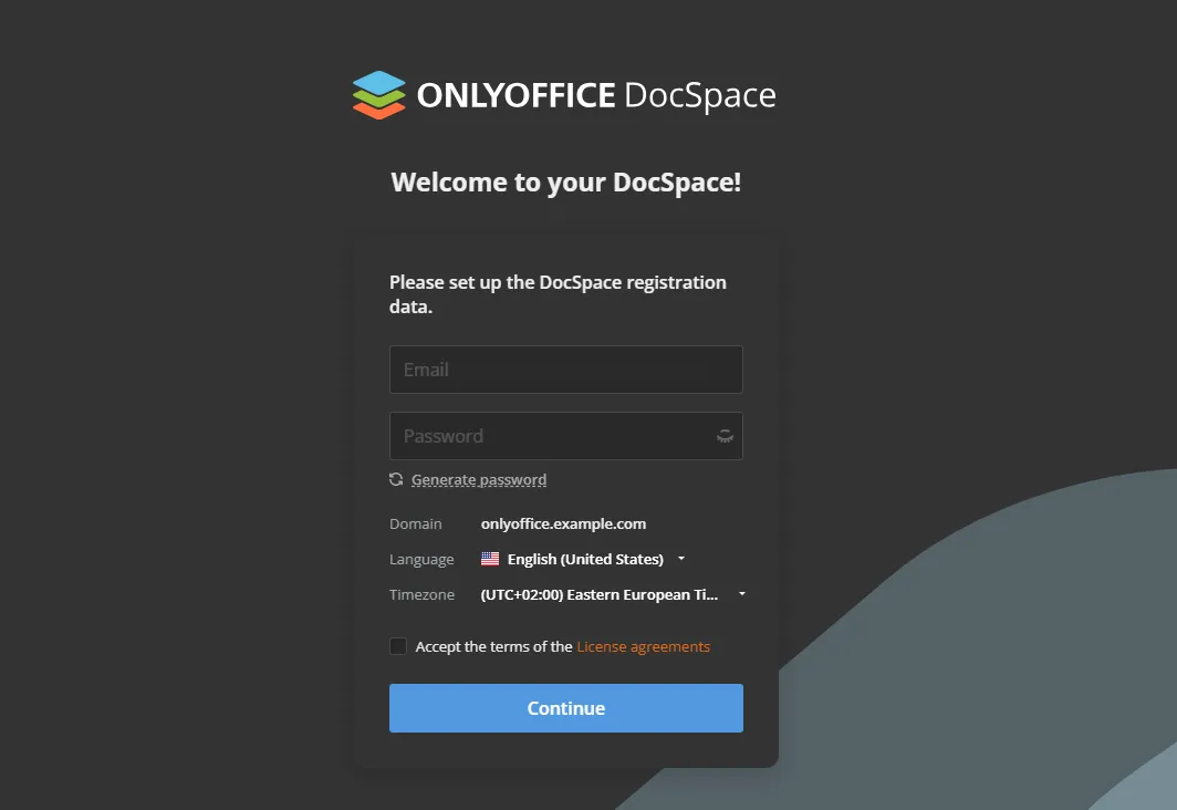

  1. Access your OnlyOffice domain using a web browser such as Chrome.
    https://onlyoffice.example.com
  2. Verify that the OnlyOffice setup interface displays in your web browser.
    Create a new OnlyOffice Administrative User Account
  3. Enter your administrative user email address in the Email field for use with OnlyOffice.
  4. Enter a strong password in the Password field or click Generate password to create a new random password.
  5. Select your language and click Timezone to set a new timezone to use with the OnlyOffice server.
  6. Accept the OnlyOffice license terms.
  7. Click Continue to create the new administrative user and redirect to the main OnlyOffice dashboard.

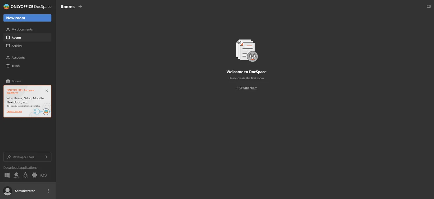

  8. Verify that the OnlyOffice interface displays correctly in your web browser to set up new rooms.
    Access the OnlyOffice Interface
  9. Click the + symbol next to Rooms to create a new OnlyOffice room.

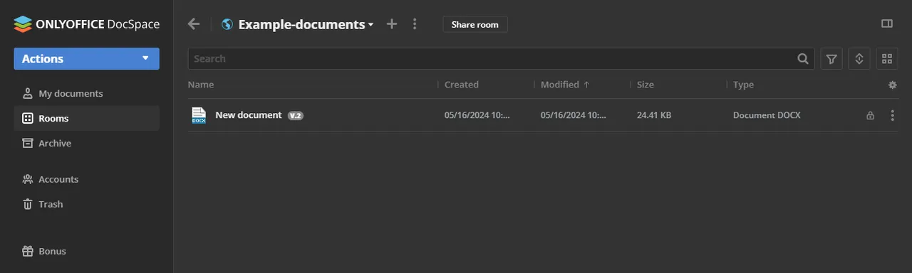

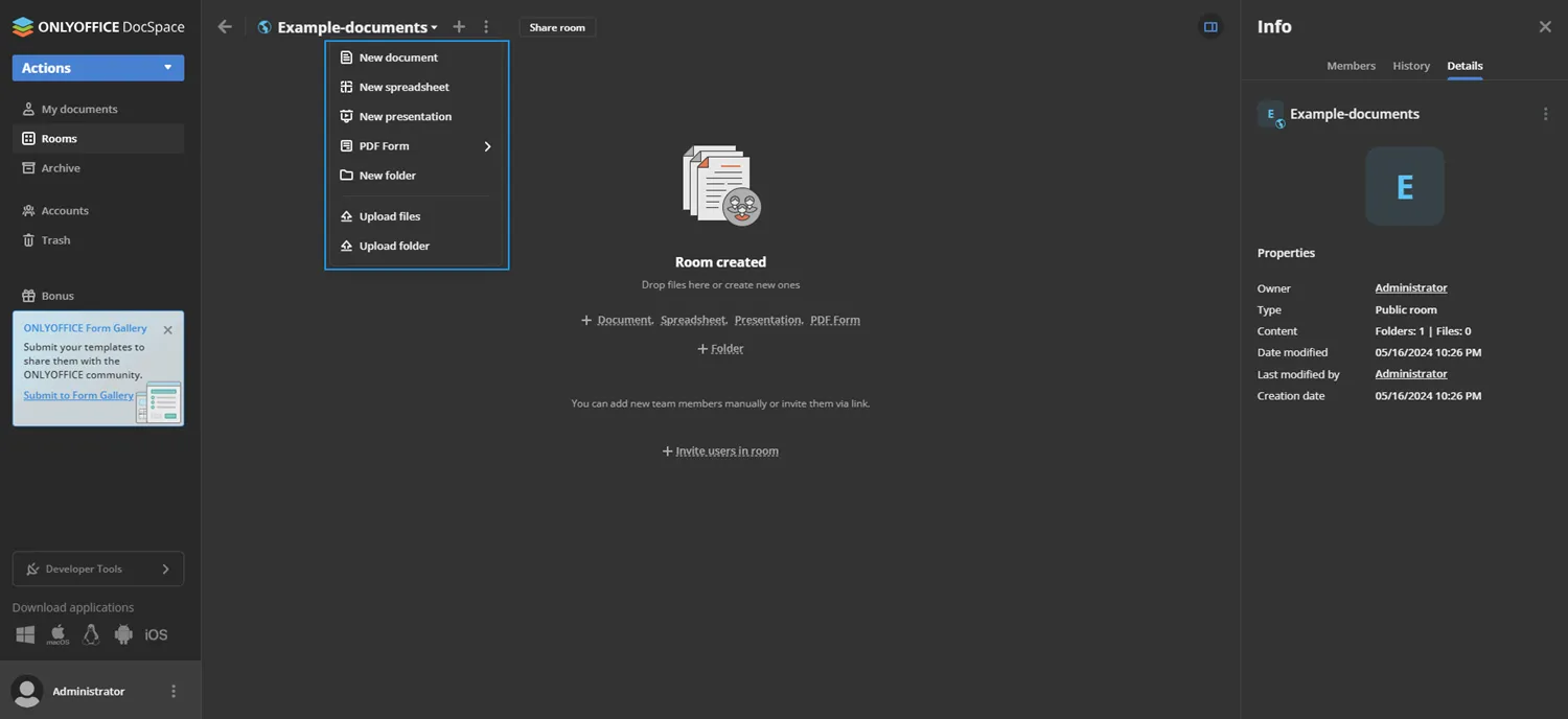

    Create a new OnlyOffice Room
    For example, click Public room to set up a new public room that allows external users to access shared documents on your server.
  11. Enter your new OnlyOffice room in the Name field.
  12. Enter a new tag, click Create tag, and upload a new image to customize your new public room information.
    Create a new OnlyOffice room
  13. Click Create to apply the new OnlyOffice room on your server.
  14. Click + next to the room name and select a new document type to create on your server. For example, New document to set up a word document.

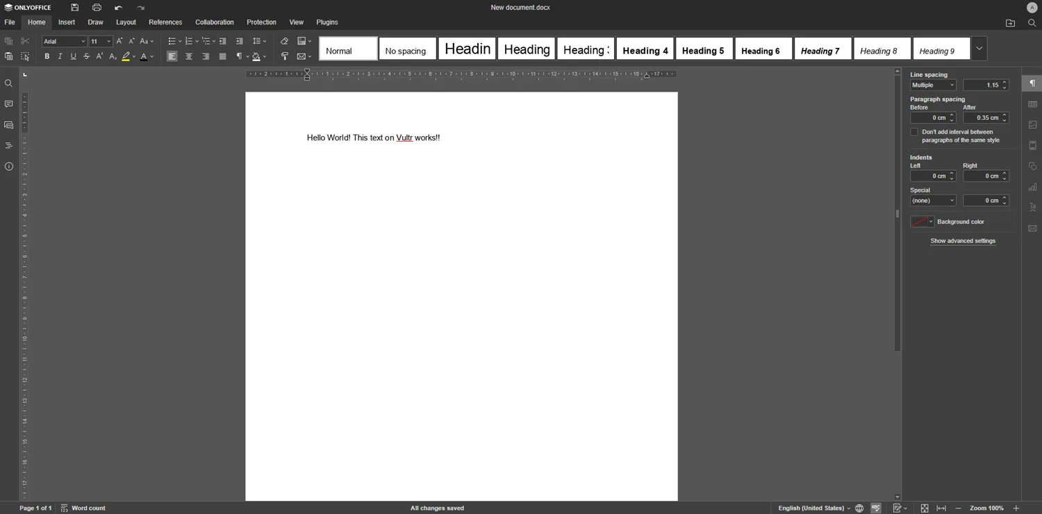

    Create a new Document in an OnlyOffice Room
  15. Enter your new document name and click Create to open the new OnlyOffice document.
  16. Verify that the new document loads in your web browser and enter sample text to test write privileges on the file.
    Open a new OnlyOffice Document
  17. Click File on the main navigation menu.
  18. Select Save to apply the file changes and save the new document on your server.

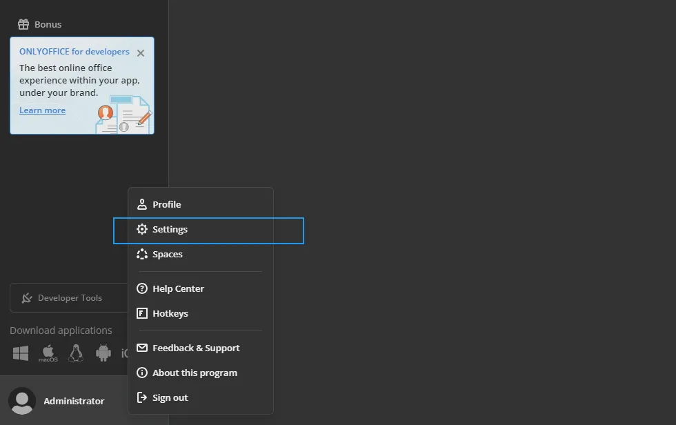

  1. Access the OnlyOffice web interface.
  2. Click options next to the Administrator user card and select Settings from the list of options.
    Access the OnlyOffice Settings Page

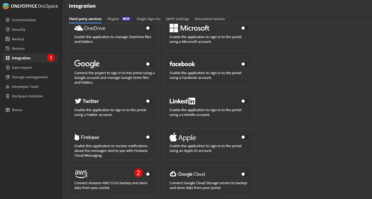

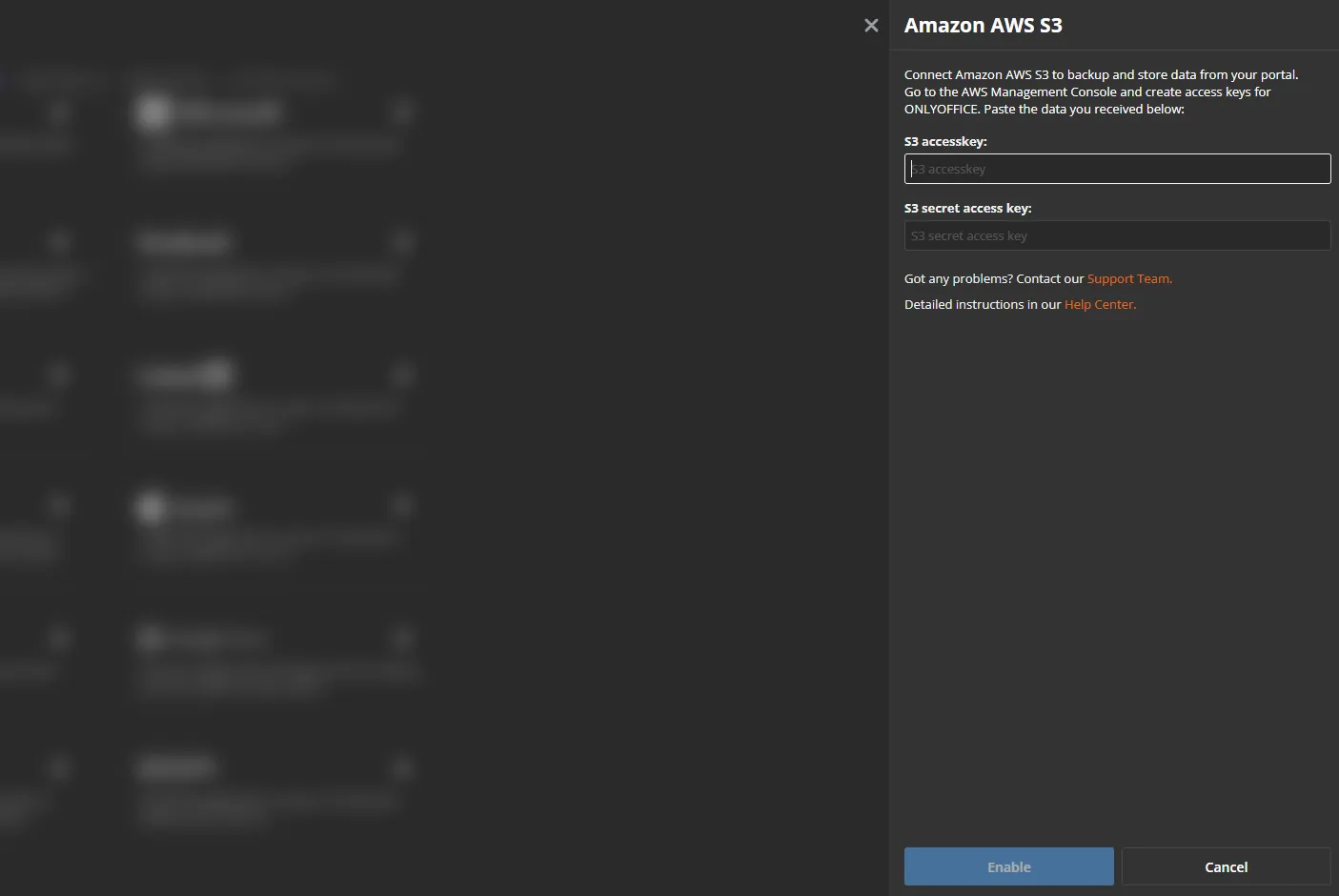

  3. Click Integration on the settings navigation menu to install new plugins.
  4. Within the Third-party services, scroll and click the AWS activation button to access the configuration page.
    Access the OnlyOffice integration plugins
  5. Enter your Vultr Object Storage credentials in the S3 accesskey and S3 secret access key fields respectively.
    Enable the OnlyOffice S3 Third Party Service Plugin
  6. Click Enable to apply your credentials and activate Vultr Object Storage as the active S3 storage service on your server.

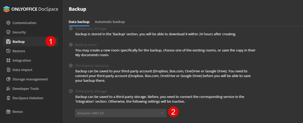

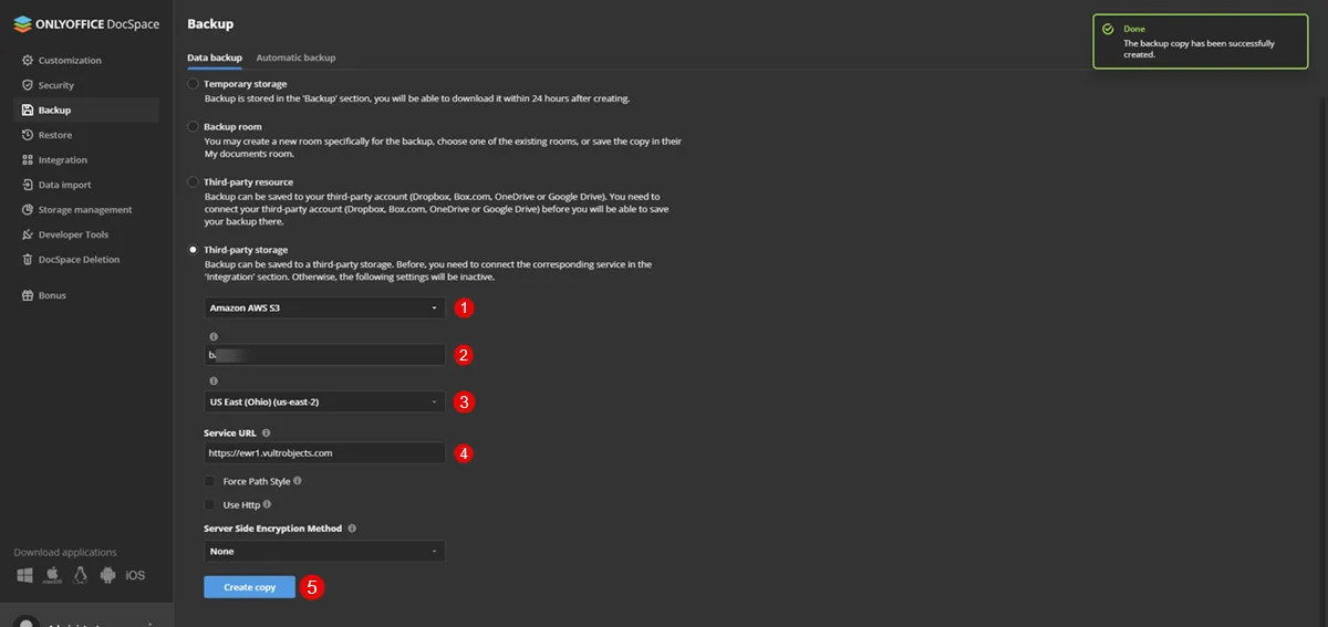

  7. Navigate to Backup on the main navigation list.
  8. Click Third-party storage in the Data backup section to back up OnlyOffice to Vultr Object Storage.
    Access the OnlyOffice Backup Options
  9. Select Amazon AWS S3 from the list of storage options and enter your Vultr Object Storage bucket in the Bucket field.
  10. Click the region drop-down and select the closest location to your Vultr Object Storage region.
  11. Enter your Vultr Object Storage hostname URL in the Service URL field.
  12. Click Create Copy to create your first OnlyOffice backup copy.
    Enter Vultr Object Storage Backup Details
    Verify that the OnlyOffice backup is successful. The dashboard displays a popup message that reads, "The backup copy has been successfully created."

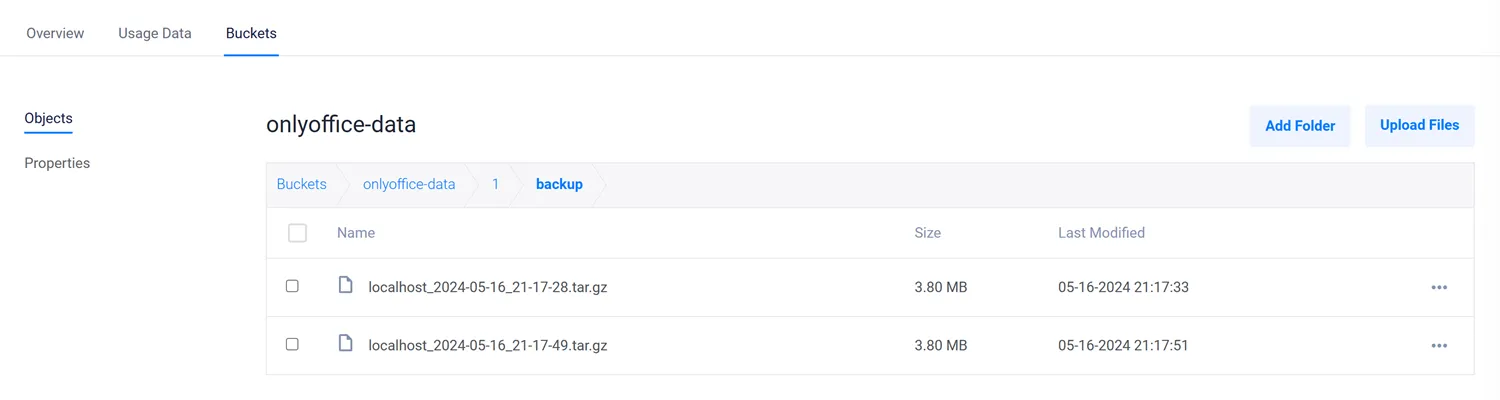

  13. Access your Vultr Object Storage bucket and verify that the new OnlyOffice backup objects are available.
    View OnlyOffice Files in Vultr Object Storage

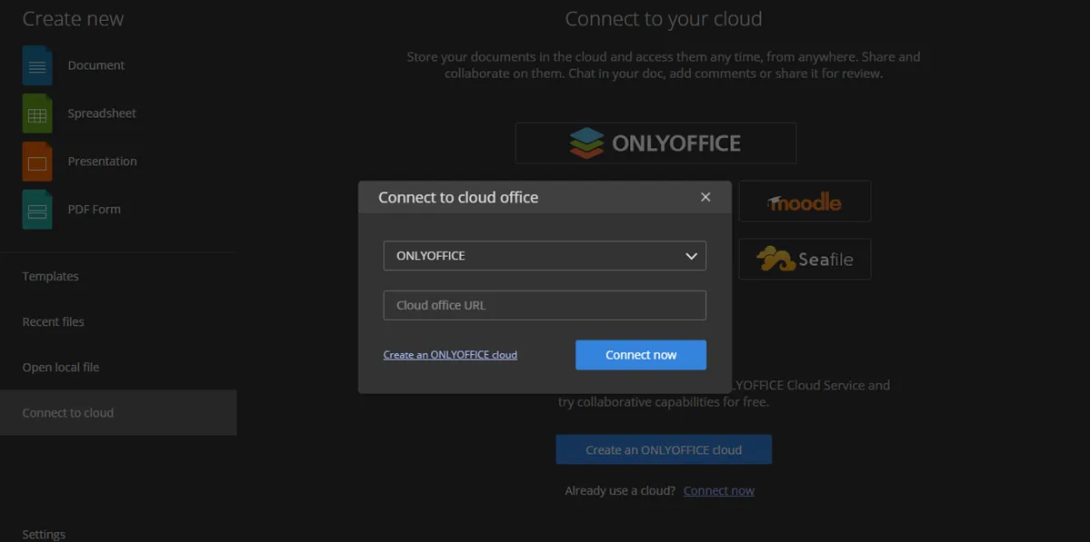

  3. Click Connect to cloud with the OnlyOffice interface.
    Open the OnlyOffice Desktop Editors Interface
  4. Click Connect now below the Create an ONLYOFFICE cloud button to set up a new connection to your DocSpace server.
  5. Enter your OnlyOffice server URL in the Cloud office URL field. For example, https://onlyoffice.example.com.
    Enter the OnlyOffice Server URL to connect to cloud

    Sign in to OnlyOffice Web Office
  7. Click Sign in to validate the user details and connect to your OnlyOffice document server.
  8. Open your OnlyOffice rooms to view and create new documents on your server using the desktop application.
    Create OnlyOffice documents using the OnlyOffice Desktop Editors Application
