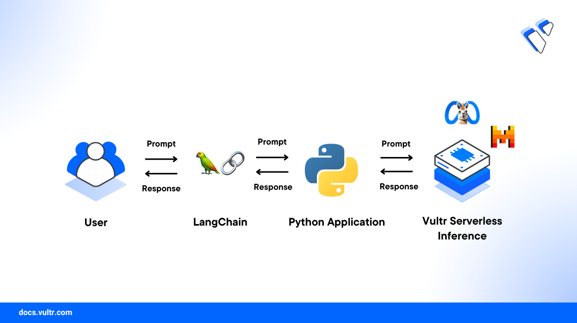

Vultr Serverless Inference allows you to run inference workloads for large language models such as Mixtral 8x7B, Mistral 7B, Meta Llama 2 70B, and more. Using Vultr Serverless Inference, you can run inference workloads without having to worry about the infrastructure, and you only pay for the input and output tokens.
This guide demonstrates step-by-step process to start using Vultr Serverless Inference in Python with Langchain.

Langchain provides a Python SDK to run inference workloads for Vultr Serverless Inference. You can use the langchain-openai package to make the API calls.
Create a new Python file name inference_langchain.py.
Add the following code to inference_langchain.py.
Run the inference-langchain.py file.
Here, the inference_langchain.py file uses the langchain-openai package to run inference workloads for Vultr Serverless Inference. Langchain uses Langchain Expression Language (LCEL) for defining different types of messages such as HumanMessage and SystemMessage. For more information, refer to the Langchain documentation.
