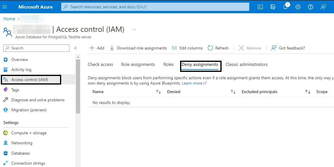

Navigate to Access control (IAM)>deny assignments, ensure permission to perform migration is not denied. If denied, enable permission.

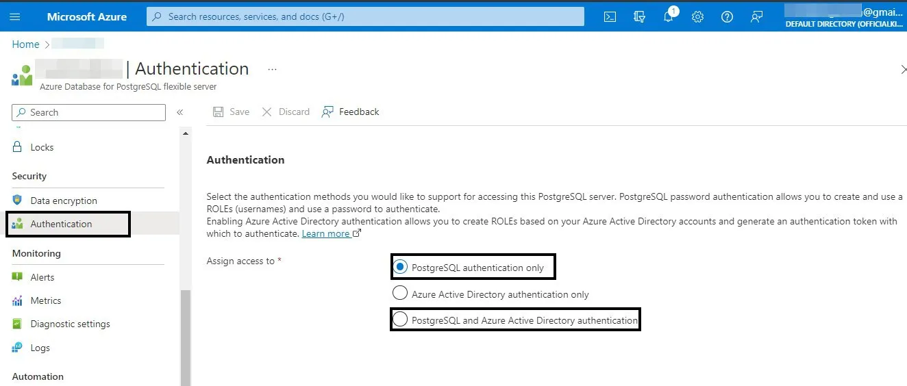

Navigate to Authentication, enable PostgreSQL Authentication.

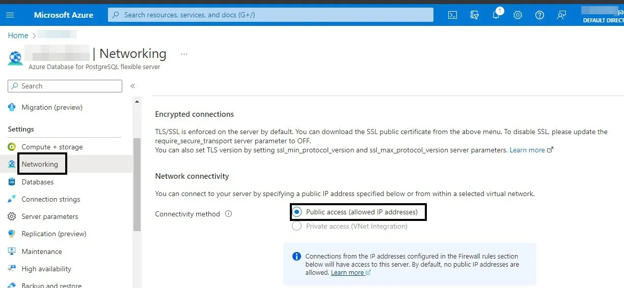

Navigate to Networking>Network connectivity, enable public access (allowed public IP address).

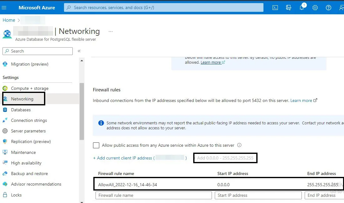

Below the Network connectivity option, enable your firewall rules to Allow all IP, which makes your database publicly accessible.
