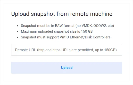

After the transfer completes, use the public URL of the One-Click LAMP server to add the image as a Vultr Snapshot.
Navigate to Products > Snapshots > Add Snapshot in your Vultr Console.
Enter the URL of your image and click Upload.
Restore the server snapshot, following the steps from the VPS Snapshots Quickstart Guide. Ensure the VPS SSD is the same size or larger than the server snapshot.
