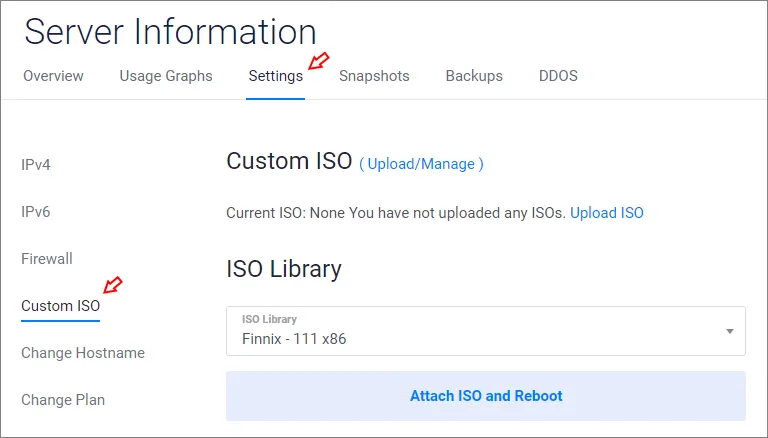

You may choose any ISO in the Vultr ISO library, or upload one. To attach an ISO to your server, go to the Server Information page in the Vultr Console. Select Settings > Custom ISO. Select your ISO, then click Attach ISO and Reboot.
Your server will reboot from the ISO. Connect to your server with the web console to perform the rescue steps.
