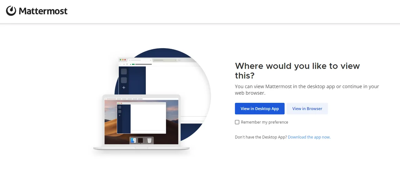

Mattermost displays a setup wizard on first access to create the administrator account and configure the workspace.
Open a web browser and navigate to your Mattermost domain.
Verify that the Mattermost setup interface loads in your browser.

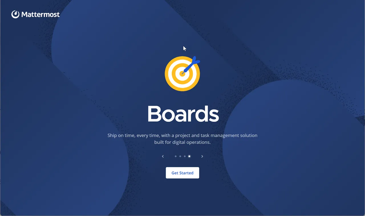

Click View in Browser to access the account setup options.

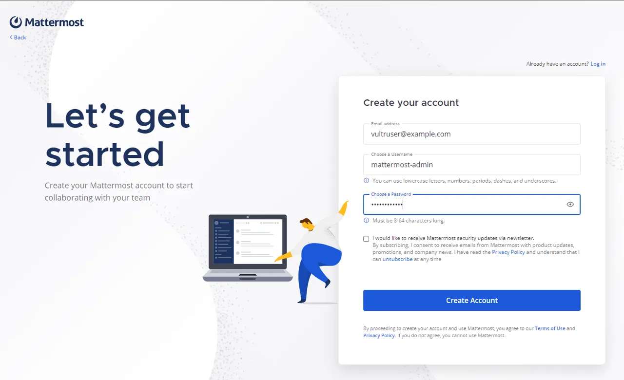

Enter your email address in the Email address field within the Create your account form.
Enter your administrator username in the Choose a Username field, then enter a strong password.
Click Create Account to create the administrator account.

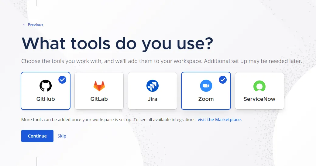

Select the external tools to activate in your Mattermost workspace and click Continue to save the selection. For example, select GitHub and Zoom.

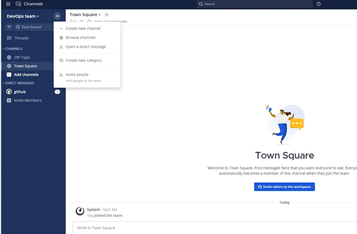

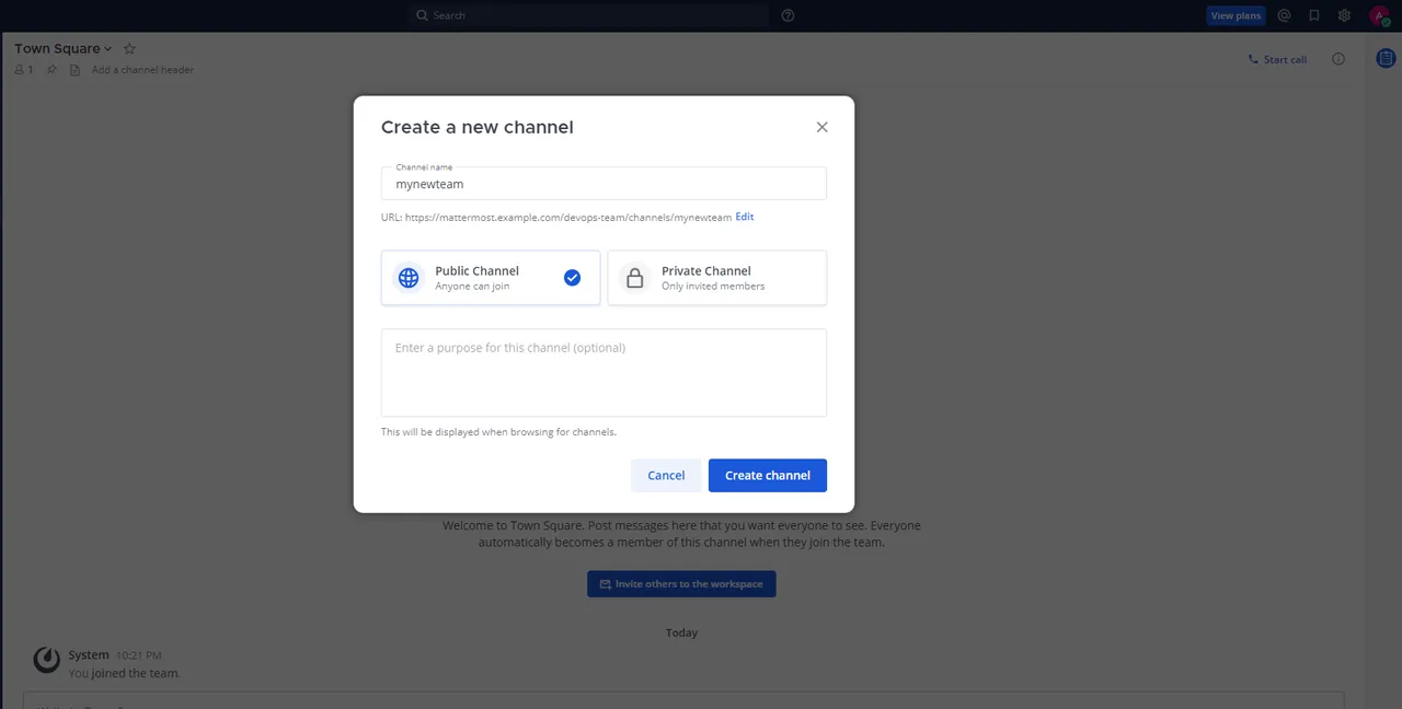

Click Browse or Create Channels next to your Mattermost team name to set up a new channel.
Select Create new channel from the list of options.
Enter a channel name and set your visibility options. For example, enter mynewteam and select Public Channel to allow all workspace users to access the channel.
Enter a channel description and click Create channel.
Verify that the channel appears in the Channels list.

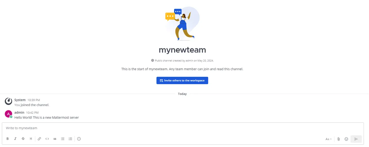

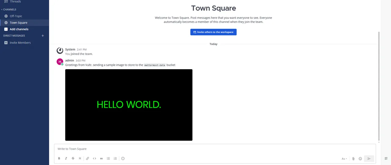

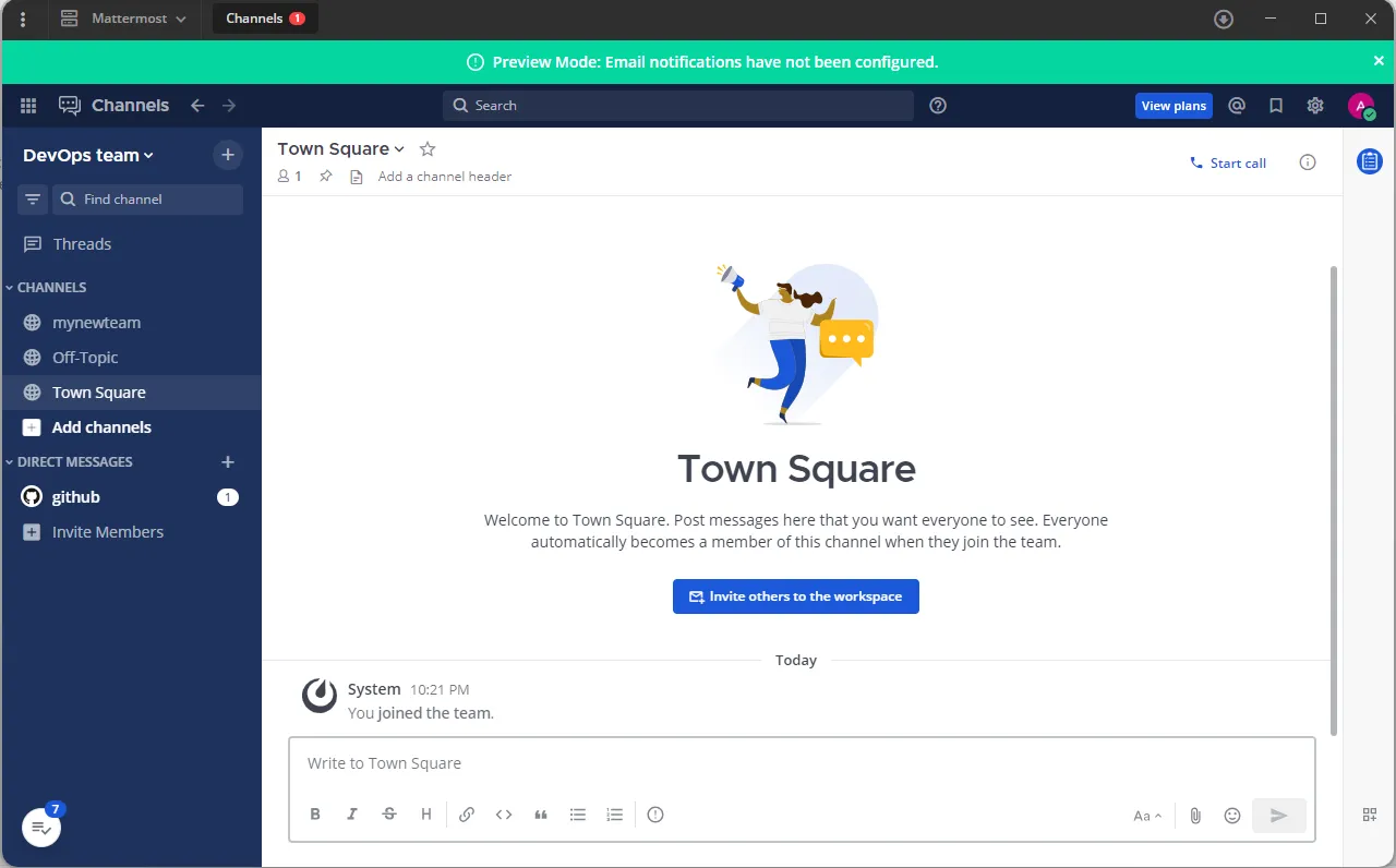

Enter a sample message in the channel to verify that the server is working correctly. For example, enter Hello World! This is a new Mattermost server and press Enter to send the message.
Verify that the message appears in the channel.

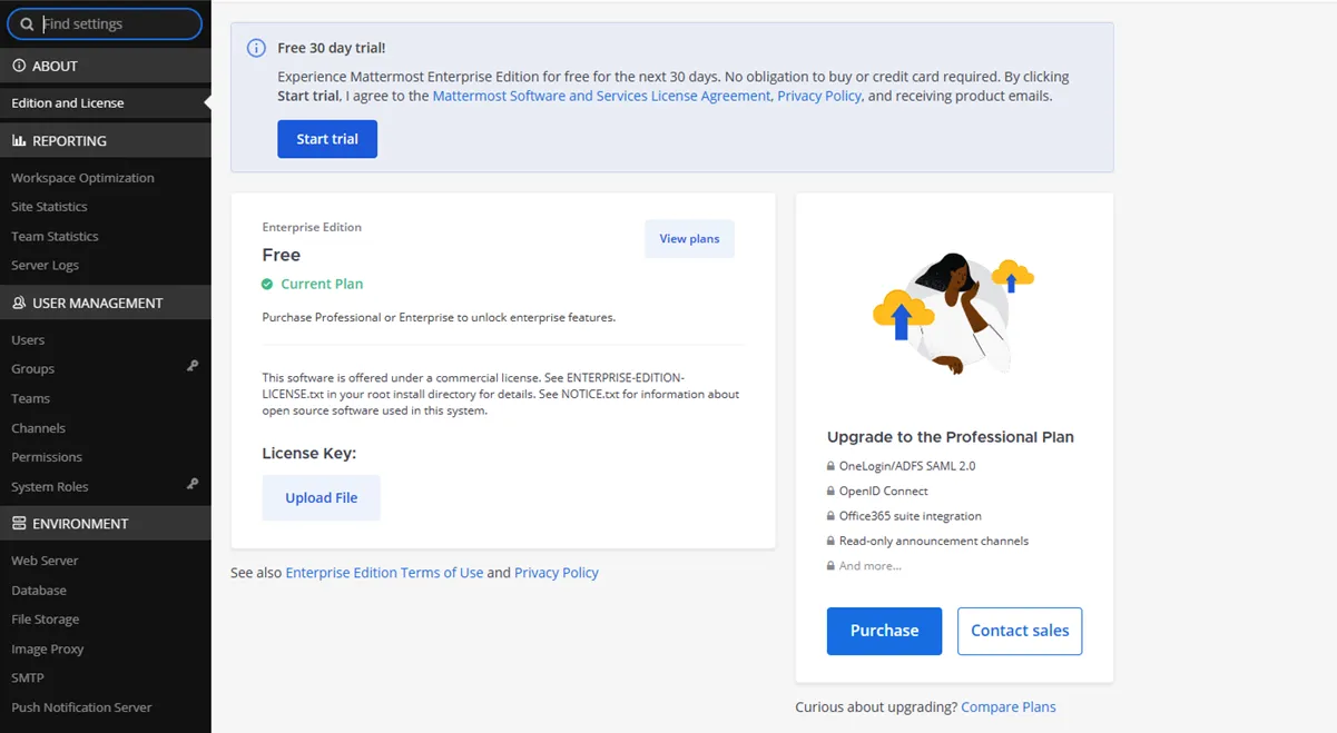

Open the main Mattermost menu next to Channels on the top navigation bar and select System Console to open the administrator console. Alternatively, navigate to /admin_console on your domain.
Verify that the Mattermost administrator console loads and displays the edition and license version installed on your server.

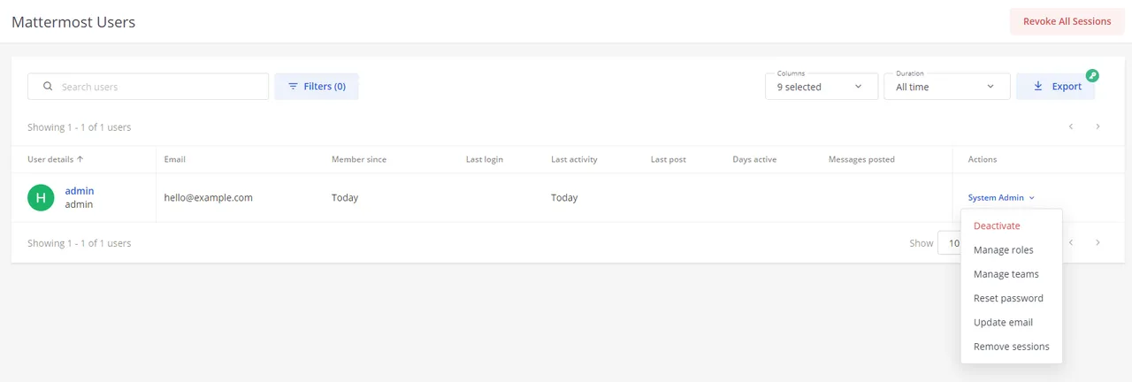

Find the USER MANAGEMENT section in the main navigation menu and click Users to view the list of workspace users.
Verify the user list and click the Actions menu to modify user roles.
Click Save to apply your changes.

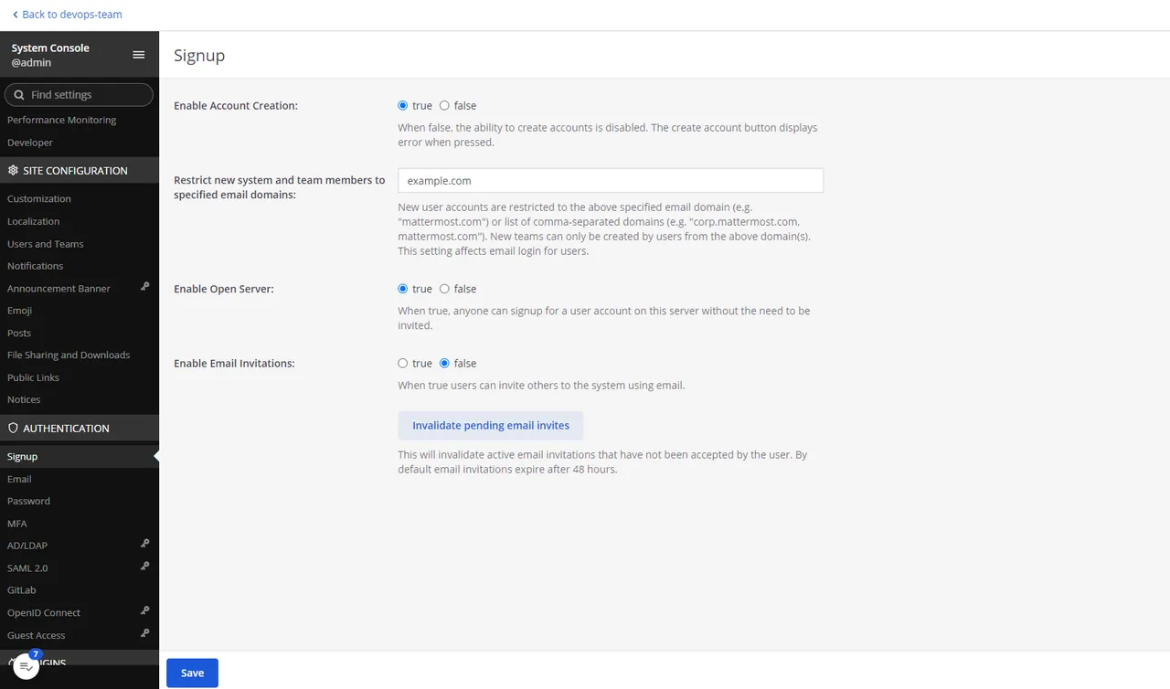

Find the AUTHENTICATION section in the main navigation menu and click Signup to configure how users register.
Enter a comma-separated list of domain names in the Restrict new system and team members…. field to limit registration to specific email domains. For example, enter example.com,example.net.
Set Enable Open Server to true to allow new users with matching email domains to create accounts. Keep it set to false to disable self-registration and accept only invited users.
Click Save to apply the workspace configuration.
Mattermost sends notifications through an SMTP server. A Preview Mode: Email notifications have not been configured. alert displays in the interface when email is not configured. These steps install and configure Postfix as a send-only SMTP server for outgoing notifications.

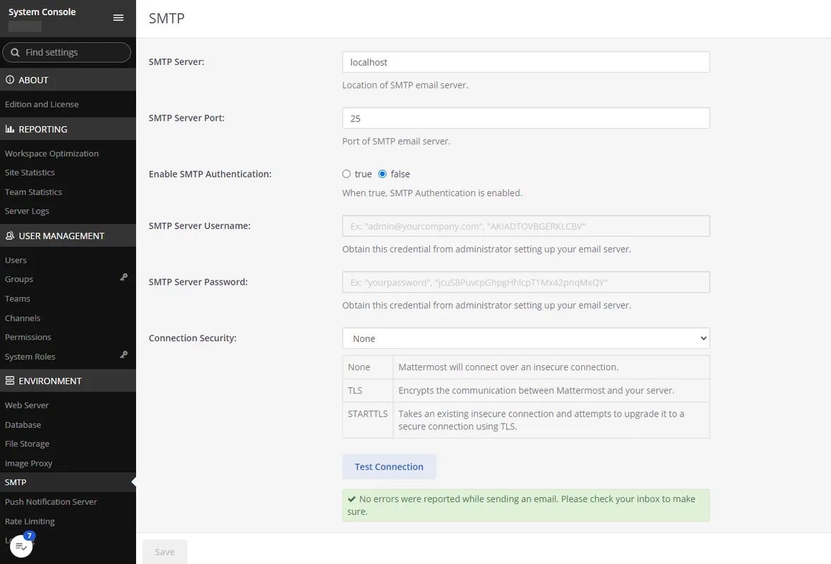

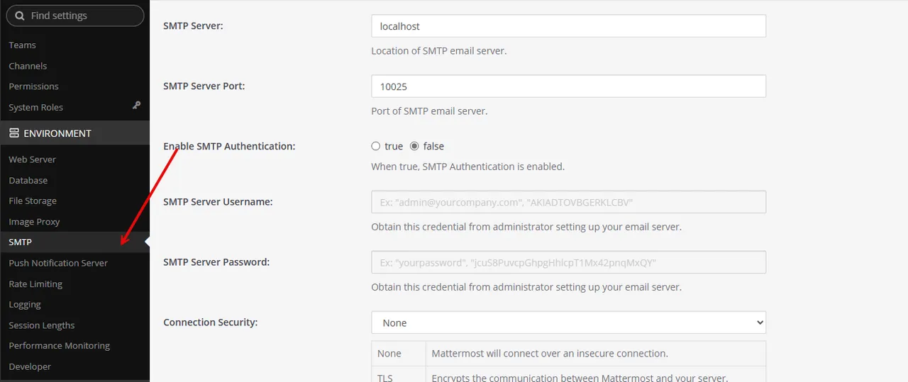

Open the Mattermost administrator console.
Find the ENVIRONMENT section in the main navigation menu and click SMTP to modify the email configuration.
Keep localhost as the SMTP Server value.
Replace the default value 10025 with 25 in the SMTP Server Port field.
Set Skip Server Certificate Verification to true to disable verification of the Postfix certificate.
Click Save to apply the SMTP configuration.
Click Test Connection to validate the SMTP connection. Verify that a No errors were reported while sending an email. Please check your inbox to make sure. message appears.

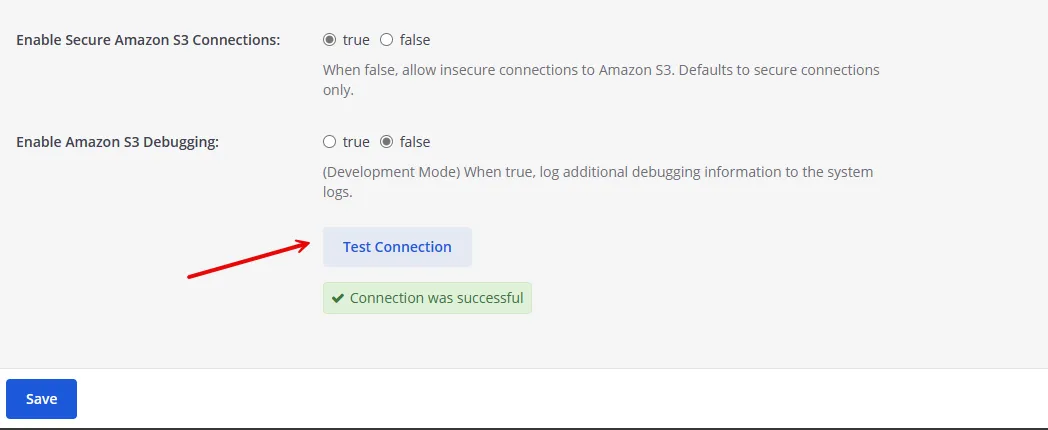

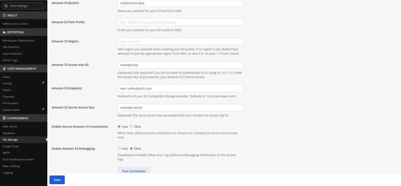

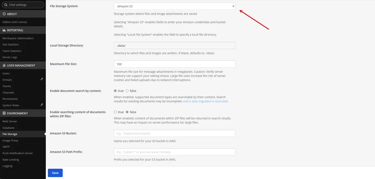

By default, Mattermost stores file and image attachments in /opt/mattermost/data. Vultr Object Storage provides an S3-compatible endpoint that Mattermost can use instead, keeping attachments off the server disk.
Find the ENVIRONMENT section in the main navigation menu and click File Storage.
Click the File Storage System dropdown and select Amazon S3.
Enter your Vultr Object Storage bucket name in the Amazon S3 Bucket field.
Leave the Amazon S3 Path Prefix and Amazon S3 Region fields empty.
Enter your Vultr Object Storage access key in the Amazon S3 Access Key ID field.
Enter your Vultr Object Storage hostname in the Amazon S3 Endpoint field.
Enter your Vultr Object Storage secret key in the Amazon S3 Secret Access Key field.
Keep Enable Secure Amazon S3 Connections set to true.
Click Save to apply the file storage configuration.
Click Test Connection to validate the credentials. Verify that a Connection was successful message appears.

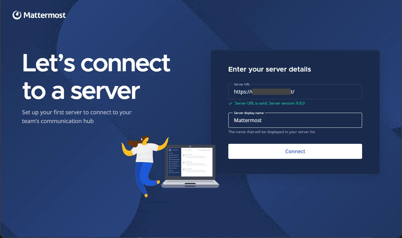

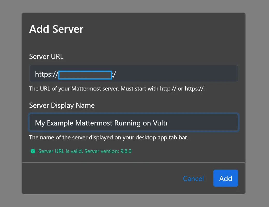

Mattermost provides client applications for Android, iOS, and desktop. Each client connects to your self-hosted server using the server URL and your workspace credentials.
Download and install the Mattermost application for your device. For example, Mattermost for Android.
Open the Mattermost application on your device.
Click Get Started.
Enter your Mattermost domain URL in the Server URL field.
Enter a display name in the Server display name field to identify your Mattermost workspace on the device.
Verify that a Server URL is valid. Server version: prompt appears below the URL field and click Connect.
Enter your workspace email and password to log in.
To create a new user account, click Don't have an account to access the signup form. When the account is created, open your invite link in a browser and log in to join a Mattermost channel.
Verify that the client application can access all enabled channels on the server.
