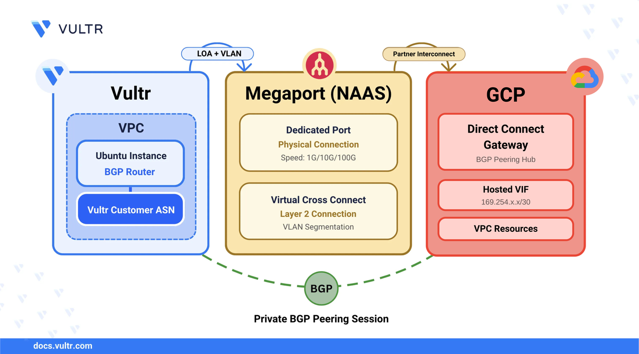

Vultr Direct Connect allows you to establish a dedicated, private network connection between your Vultr infrastructure and your on-premises environment or other cloud providers. This connection bypasses the public internet to deliver a more reliable, secure, and low-latency network experience. It provides predictable performance, committed network bandwidth, enhanced security, and reduced data transfer costs, making it ideal for hybrid cloud architectures, high-volume workloads, and latency-sensitive applications.
In this guide, you will create a private, low-latency connection between Vultr and GCP using Direct Connect hosted through Megaport. You will provision a dedicated port, order a Virtual Cross Connect (VXC) using Megaport, configure the connection on both Vultr and GCP, and verify the setup by testing BGP route advertisements and end-to-end connectivity between your Vultr and GCP resources.
