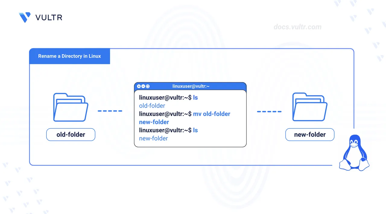

-i or --interactive: Prompts for confirmation before overwriting an existing file or directory.-n or --no-clobber: Prevents overwriting an existing file or directory.-v or --verbose: Displays a verbose output of the operation.-T or --no-target-directory: Treats the target as a normal directory and not as a destination directory into which the source should be moved.In Linux, renaming a directory is done using the mv (move) command. You only need to specify the source name of the directory followed by the new name you want to assign. This section explains how to rename a directory in Linux, along with the flags that modify the behavior of the command.
Use the mv command to rename the current_dir directory to renamed_dir.
The above command renames the directory current_dir to renamed_dir, only if the renamed_dir directory does not already exist. If the renamed_dir directory does exist, the command will move the current_dir directory inside the renamed_dir directory instead of renaming it.
