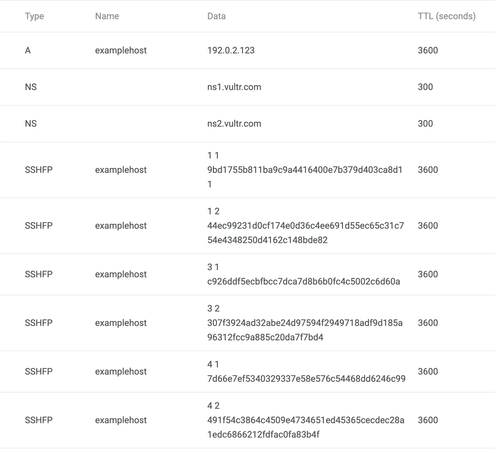

Add the SSHFP records you generated with the ssh-keygen command to your domain's DNS records. You should create a new SSHFP record for each line. Make sure that the hostname of the SSHFP record is the same as the hostname of your server.
If you're using Vultr DNS, your DNS entries should look similar to this:
