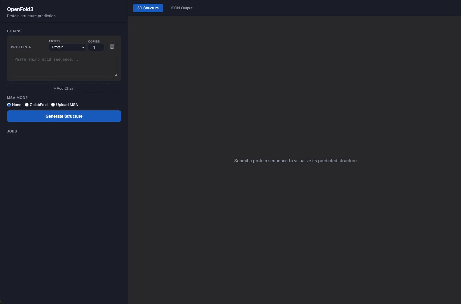

Verify that the OpenFold3 prediction interface loads in your browser.

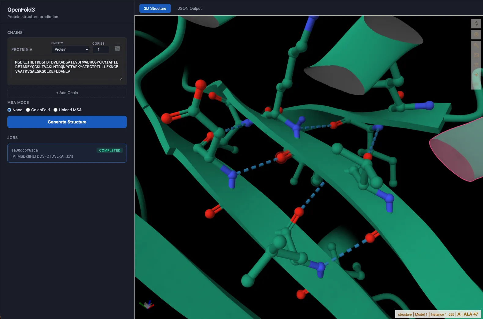

Enter one or more chains (protein, RNA, DNA, or ligand) in the input panel. Use the following example protein sequence to test the deployment:
Select a Multiple Sequence Alignment (MSA) Mode for the prediction:
.a3m MSA file for full control over the alignment.Click Submit to start the prediction. The UI displays the progress and renders the predicted 3D structure when complete.
You have successfully deployed the AMD AI Workbench OpenFold3 UI VKE Application on a Vultr Kubernetes Engine cluster. You can now submit protein structure prediction jobs directly from the browser, backed by AMD Instinct™ GPU acceleration.
