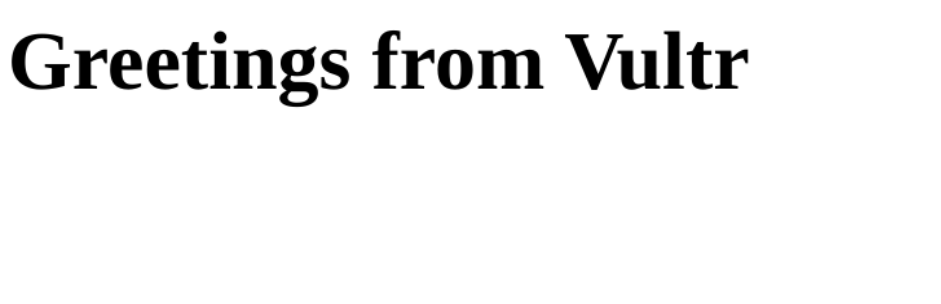

This creates a webpage that returns Greetings from Vultr on the home route /.
Run the Flask application.
Access your Flask app using the following address in a web browser. Replace <SERVER-IP> with your server’s IP address.
To stop the Flask app press Ctrl+C in your terminal session.
