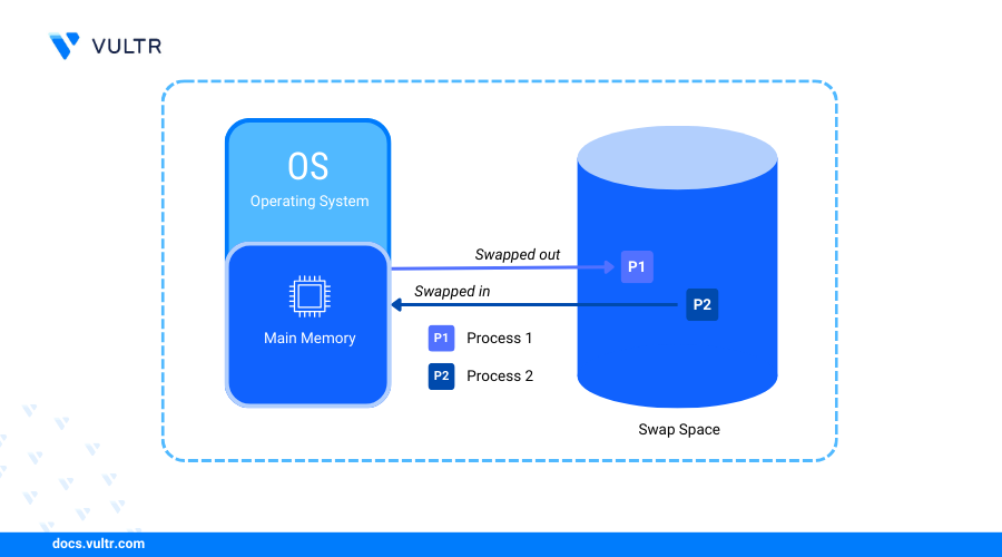

Swap memory is extra storage used when your server's RAM is full. It moves less active processes from RAM to a reserved space on disk, freeing up memory and preventing system crashes.
In this article, you are to add swap memory on Ubuntu 22.04. You are to use a block storage to increase the available server memory.
