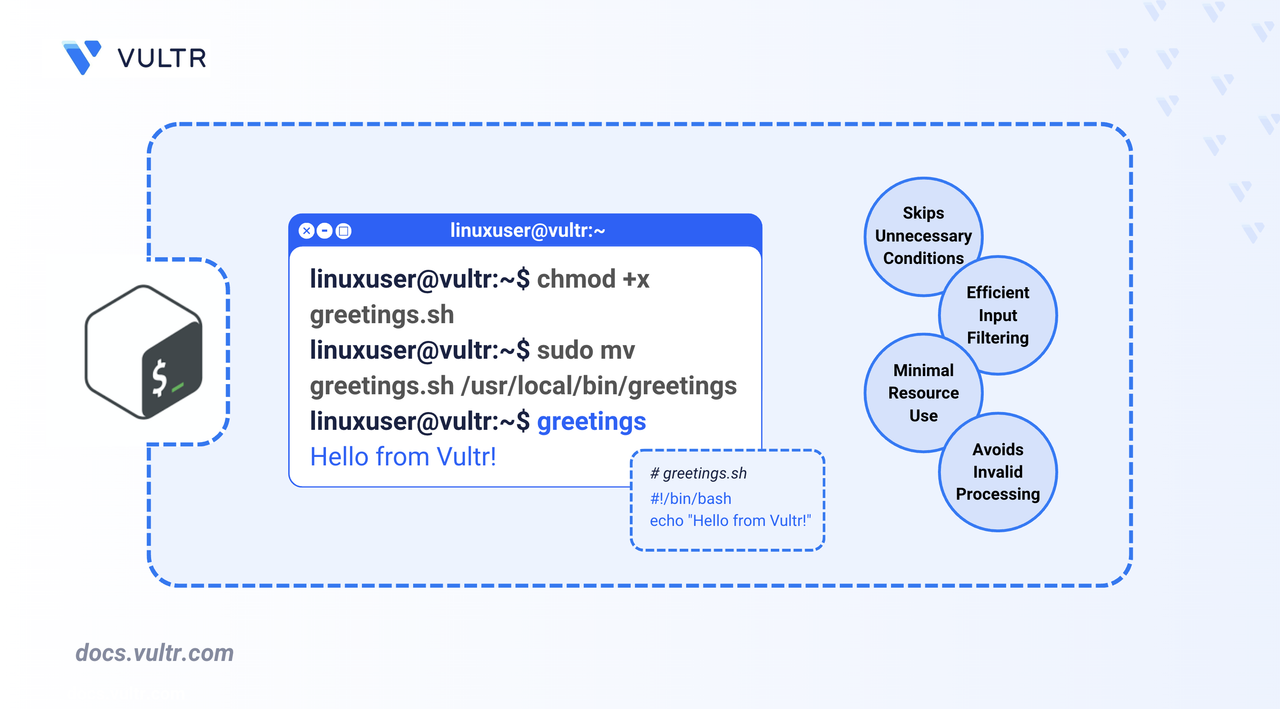

Set execute permissions for the script.
The command:
chmod: Command to modify the permissions of files and directories in Linux.+x: Grants execute permission to the file owner, group, and others.greetings.sh: Represents the target file.Verify the file permissions again.
The target file greetings.sh in the output should turn green or a different color depending on your terminal’s color theme to indicate it's now an executable file and can be run from your terminal.

To conveniently access a bash script from anywhere on your system, you must place it in a directory that is already part of your system’s PATH environment variable. Within the PATH environment variable, your shell searches for the file when you type a command. Any script in a PATH directory automatically transforms from a local script that only works in its creation directory into a system-wide command/utility that can be executed from any location on your filesystem.
In the steps below, view your PATH environment variable and move your bash script to /usr/local/bin/.
View your PATH environment variable.
The output above shows the list of directories in the PATH environment variable. These directories contain executables and binaries that can be run from anywhere in the system.
Navigate back to your home directory.
Move your bash script to /usr/local/bin.
Verify that your script is globally accessible.
The /usr/local/bin directory includes user-installed programs and scripts; it is already included in your PATH and thus doesn’t interfere with system-managed packages. However, sudo is required to move your files to the /usr/local/bin directory, as it is a system directory. In addition, all users can access and use scripts here.
