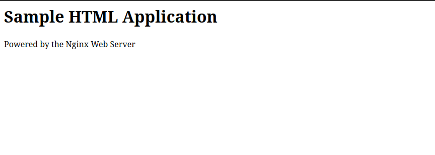

The HTML application displays when the Nginx web server loads all supported files for display in a web browser.

Test access to your domain and confirm that the web application loads.
