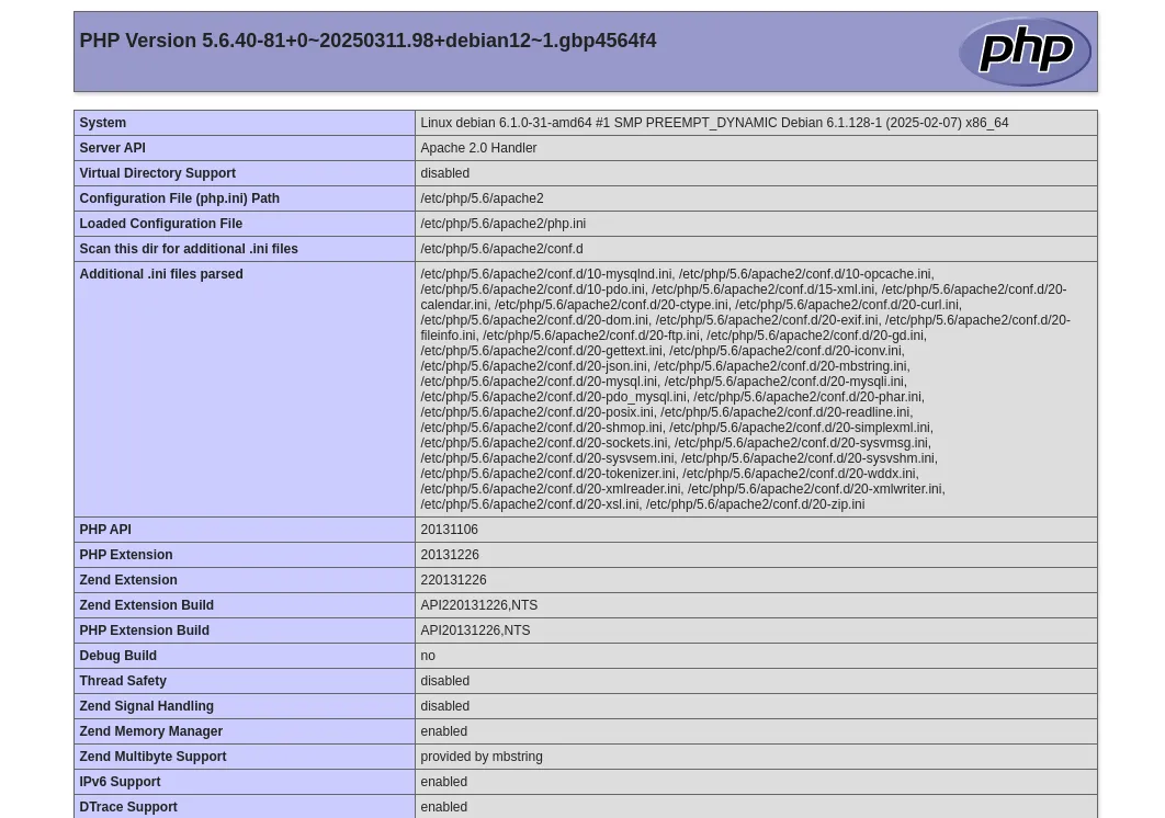

Before proceeding, verify that PHP 5.6 is functioning. Testing helps confirm that the installation works as expected and that the necessary extensions are loaded.
Create info.php file for testing purposes.
Add the following content to this file.
The phpinfo() function displays information about your PHP environment and other system details.

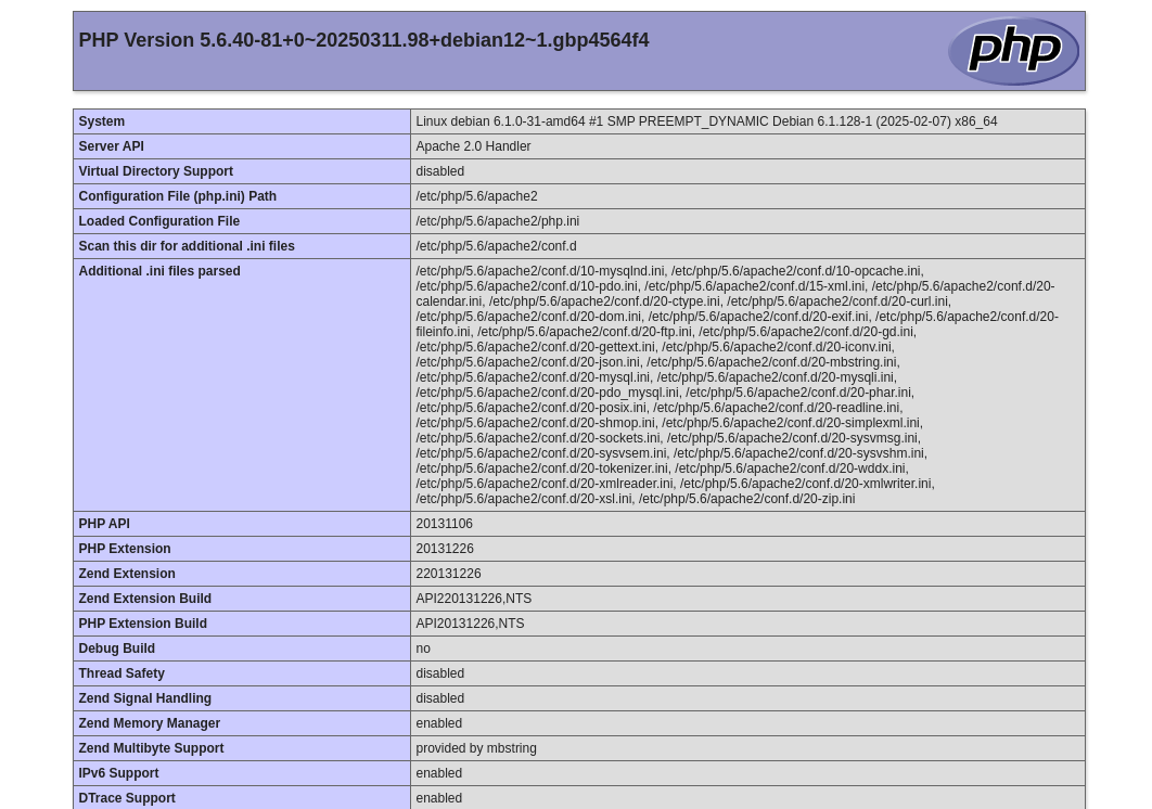

Access the info.php file from your web browser and verify that your PHP information displays.
You now have PHP 5.6 and PHP-FPM 5.6 installed on your Debian 12 instance. As tested, your instance can now process and serve PHP files. This version of PHP is obsolete and insecure. Use it only for legacy application testing. For production environments, upgrade to a supported version of PHP 8.3.
