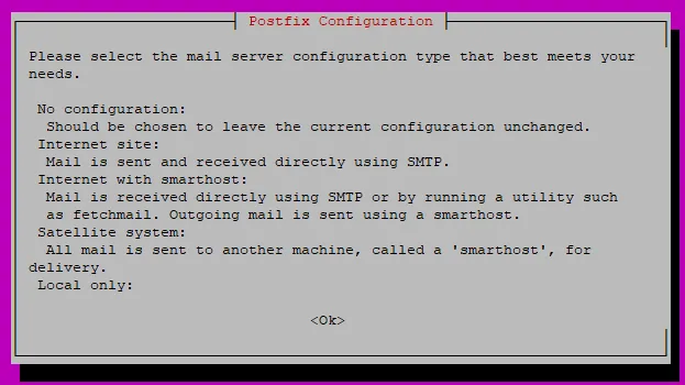

You'll get the Postfix configuration screen, as shown below. Press Tab and Enter to continue.
On the next screen, select Internet Site, then Tab and Enter.

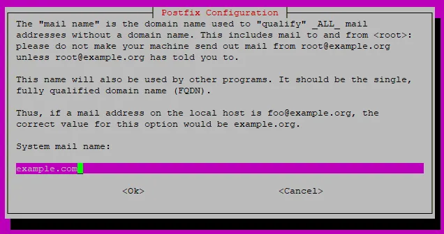

Enter the system mail name, which is your domain name. For instance, the server name is mail.example.com, so you'll enter example.com here.

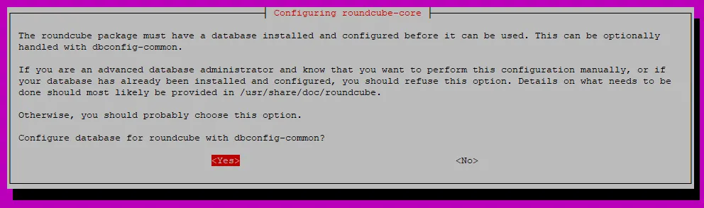

Press Enter to configure the database for use with Roundcube.
