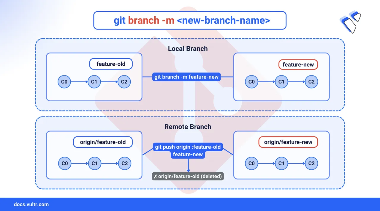

This article explains how to rename a Git branch locally and remotely, including how to do it without performing a git checkout.

A remote Git branch refers to a branch hosted on a remote repository such as GitHub. Git does not allow direct renaming of remote branches. Instead, you must rename the branch locally, push the new branch to the remote, and delete the old one.

Push the renamed branch to the remote and delete the old branch using the below command.
This pushes the feature-mfa and deletes the feature-2fa from the remote repository.
