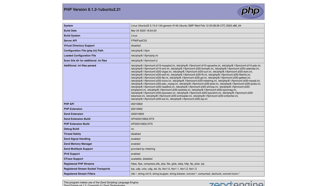

Create a new sample PHP file info.php.
The above application code displays information about the PHP version and installed modules on your server when accessed in a web browser.
Restart Apache to apply your configuration changes.
Access your domain using a web browser such as Chrome and append the /info.php path to verify that your PHP application information displays.

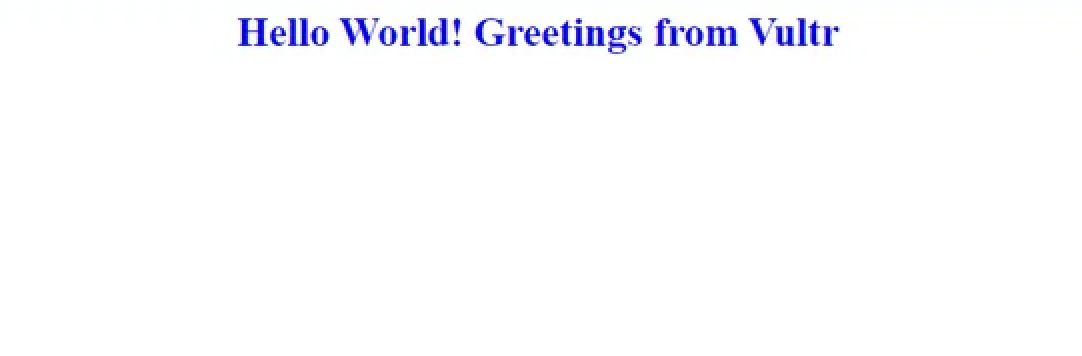

Create a new sample PHP application file setup.php in your web root directory /var/www/html/app.example.com.
The PHP code connects to the content_database MySQL database and displays data from the content column in the messages table. If no records are found, it shows No records found, or Connection Failed if the database connection fails.
Grant the Apache user www-data full privileges to your web root directory.
Access your domain using the /setup.php path in your web browser to verify that your PHP application displays the Hello World! Greetings from Vultr string content from your MySQL database.
