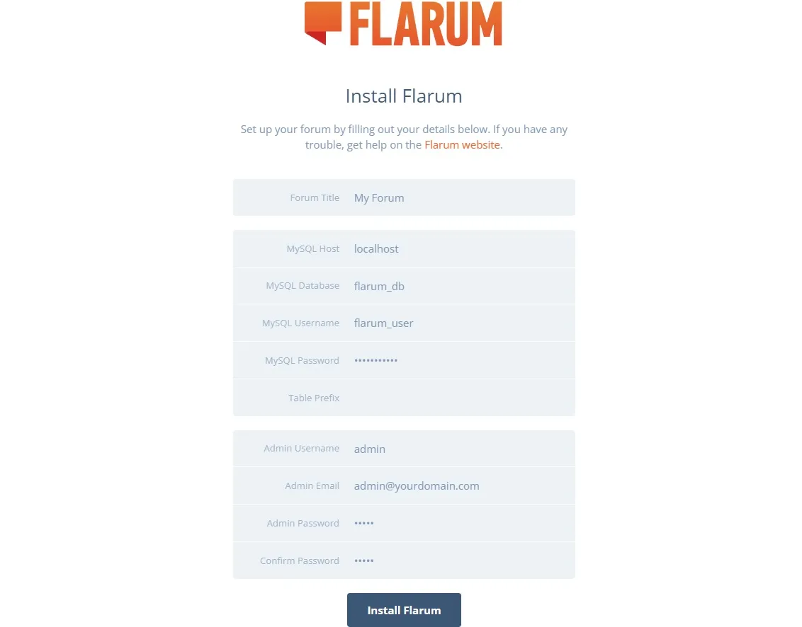

Log in to the MariaDB shell.
Create a database for Flarum. Replace flarum_db with your preferred database name.
Create a new user. Replace flarum_user with your preferred username and flarum_pass with your preferred strong password.
Grant the new user all the privileges to flarum_db.
Flush Privileges.
Exit MariaDB.

You have finished installing Flarum.
