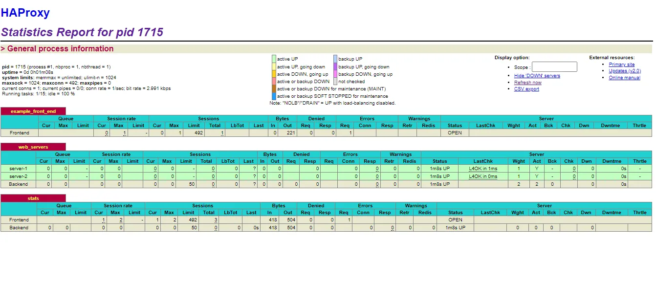

To view general statistical information about your frontend and backend servers, visit the HaProxy's server public IP address on port 32600.
Enter the login details that you defined on the stats sections in the HAProxy configuration file. For instance username:ha_proxy_admin, password:EXAMPLE_PASSWORD to log in.
You should see a dashboard with a lot of HAProxy information.
Your HAProxy server is working as expected, and indeed, you're redistributing the load from the main server to the backend servers as you had expected. In this guide, you've created two different web pages with varying content to prove the load-distribution concept. In a production environment, the contents on the redundant servers should be similar, or if you're fetching data from a database, the backend servers should display the same data. For instance, the backends should connect to a MySQL group replicated database. This helps your app to tolerate downtimes in case some of the backend servers fail.
