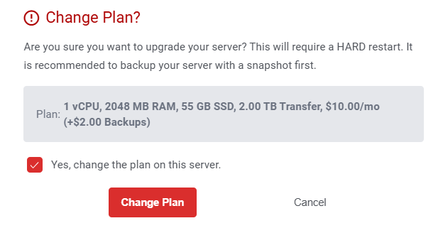

Resizing an instance activates a new plan with more vCPUs, RAM, and storage to match your needs. Downgrading is not supported while upgrading the instance enables a higher plan without changes to the instance's data or file system.
Follow this guide to resize a Vultr Optimized Cloud Compute instance using the Vultr Console, API, CLI, or Terraform.
